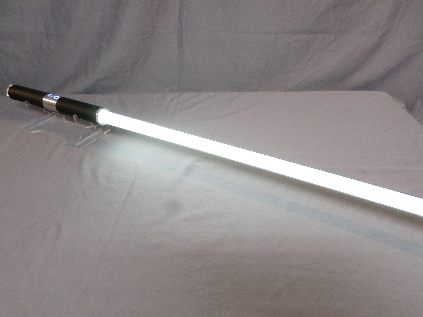

Tron Baton MHS based ~ Retro fit
Notes
I know it's not accurate to the film, as those are rectangular shaped and have 4 buttons in the middle.
TCSS custom emitter.
Custom DM AV switch piece
Wrinkle Black Powder Coating
7 Rare earth magnets on bottom to mount on thigh with out covertec or D Ring. (Non Tested)
Grid access via pommel
Specs
Crystal Shard 3.0
Tri rebel Cool White with Lime FoC
1x18650 Li-ion
Pommel accent Led mirrors blade
2 White Ring AV switches. Emitter end, main power
HB 2W speaker
RICE port in pommel
Video Tron Legacy Baton 2.0 MHS With Crystal Shard 3.0 - YouTube
Soundfont ~ Novastar Tron legacy, disc version via Saberfont.com
